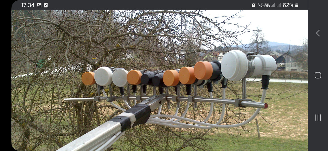

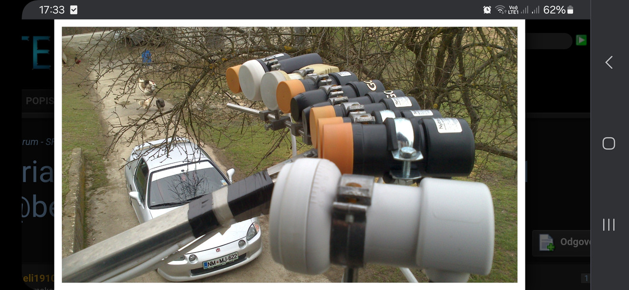

You could point the 1.20 cm antenna at Eutelsat 9º E. There are lots of fun things there. I don't know if you could receive Italian channels (MultiStream) in Belgium. I can receive them here. There are sports channels, music, movies, documentaries... etc. They are free to air and most of the frequencies are in 16APSK, they need the PLS code to be able to receive the signal, which can be easily obtained on satellite websites.
In 2011-2014 I experimented with different multifeeds on 0.6-1.6m antennas. I give you a choice, you can experiment yourself. The signal on all antennas was excellent. On the 5W you probably need to install a separate antenna. Everything depends on the fasteners = heads = LNB. Tomorrow I will open a new topic about multifeeds - /with photos/.
Print your photo of the 1.2m antenna. To see what kind of mount is needed. And also our moderator RimaNTSS, he is a super specialist in such mounts, he will tell you, I know from his work.
This mount for my antenna also fits a square trunk.-/хобота/

And it is also desirable to install =heads=LNB with a diameter of 24 and 40 mm
In the last photo with such an antenna only 5 LNBs fit

on my dish:
45°E - 42°E - 39°E - 33°E - 28° - 24°E
This is what you need for your 120cm dish.
13°E - 9°E - 1°W in the center - 5°W on the right side.
No need of slim LNB, if there is 4° between 2 LNBs

Here are 2 pictures of my 42E-5w multifeed system from 2013, when I was playing on a triax 88.
