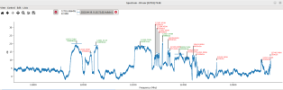

Amos 4 @ 65° E
At 65.0E, we have an example where the result depends on the card used, as Deeptho warns, capable of detecting and displaying a signal without locking it. Crazyscan has been designed so that weak signals that cannot be locked are still displayed on the spectrum. This is only valid for STV091X-based cards (6983/6903/USB5927). Other cards cannot display the nolock signal on the spectrum like the 6903x.
Whereas neumoDVB shows a weak signal subliminally without locking it-11360 V,45000,2/3. This is what IQmonitor does with the 6983 cards, and it can indicate the parameters of a mux that cannot be visualized with the image.
I will post the results at 65.0E with 6903x cards with neumoDVB and Crazyscan, and 6983.

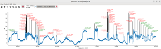

Test with neumoDVB at 70.5E, in which I notice on the spectrum that 11215 V/11230 V,51421, and 11277 V/11292 V,45000 appear on other muxes but are correctly listed on the Muxes. They are indeed displayed with the correct parameters after manual scanning.
I should also add that the auto scan with 6903x is faster with neumoDVB than Crazyscan, as is natural and has happened on every satellite I have scanned so far.

As always: there are pros and cons. crazyscan uses a different peak finding algorithm. Sometimes one is better than the other. You need some luck.
The peaks in the spectrum (frequency and bandwith) are used as an initial guess. The guess 11277H is clearly incorrect, which is due tothe non-flat spectrum which seems to happen with advanced high symbol rate modulation schemes.
BLscan2() not implemented for STiD135, used only step-by-step BLScan() without peak detection.
Express-80 @ 80° E
tbs6903x card with neumoDVB and Crazyscan on 80.0E: 10950-11700 H/V:
I thought the Muxes problem was solved with generic multi-streaming(?) that generates dozens or hundreds of streams appearing on the Muxes list that currently has no practical or other value. We have such a mux at 10974 H, which, as you can see on the list, fills the list without any purpose for us, simple users. It would be a different story if we had such an app for such (multi) streams.
On Windows, with Crazscan, this mux is single and encapsulated.
It looks like neumoDVB; such a stream is not encapsulated(?), so it populates the list with everything it finds on this stream. But whatever the nature of this stream, it would be more useful if such muxes were not repeated tens or hundreds of times.

The same problem manifests itself, for example, on 30.0W, 11676,1766,5/6,8PSK, which has 250 streams(see picture). I have exemplified this only with Crazyscan. At least on the Windows app, they are not displayed, being considered (maybe) useless as long as we don't have an app to show the content.
And you can see that the diagram is QPSK, so the whole detection is bad

That is just the way it is designed, not only for simple users... And these streams are not useless. Some of them contain interesting data. I found the operating system for an in flight entertainmens system once.
So it is NOT a problem. The only thing that changed is that scanning such muxes is now much faster,
