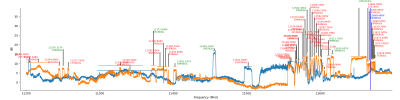

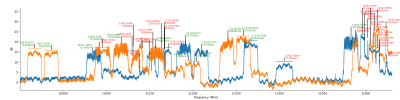

I scanned Eutelsat 12 West G with neumoDVB (and Crazyscan) using the 6909x card on the first visit to 12.5W.
Unlike the Windows app, neumoDVB also found and locked two muxes (11191 V,17143 and 11209 V,17142) that were not detected by Crazyscan.

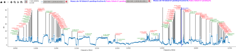

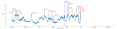

I've encountered situations when, with 6909x/(6903x) cards, the frequencies in the upper band were copied from 10950-11200 HV both under Windows and Linux.
This time, it happened the same: at 60.0E, Crazyscan (Windows) and neumoDVB (Linux) found the same frequencies from the lower band to the upper band.
I wonder if this situation is a problem with the IBU lnb used, a bug in the applications/drivers used, or a card construction error.
Why does this error occur?
