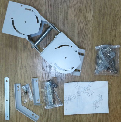

Guys I contacted a company about a polarmount for my channel master 1.8m offset dish and the sent me a picture of that polarmount,now that to me is not a polarmount that was ever associated with a cm 1.8m offset dish
Any ideas what dish it's used on ??

It's upside down.
5,205
2,610
Looks like one of the universal mounts that until recently were available on eBay from Latvia(?). If it's the same one, it was advertised as being suitable for a 'small dish'.

no matter that polarmount is of no use to me for my purpose.
