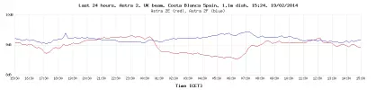

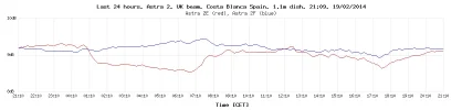

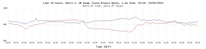

I've switched my data collection to a 1.1m dish now. Let's see how it holds up 24/7. Graph is average of all spot beam transponders, including 8PSK.
Graph:
http://satellites-xml.org/signal-graphs/last-24-hours-graph.php
Table:
http://satellites-xml.org/signal-graphs/28E-SNR-table.php

1.1m dish. All transponders remain locked 24 hours.

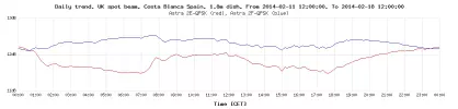

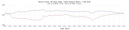

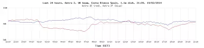

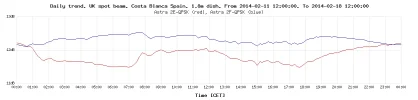

That's an impressive drop off in the early hours! Is the time period regular or does it vary? Any idea if time related or due to sat issues?
Completely regular on both satellites. Here's a graph of the average over 7 days. Compare with the highs and lows of the last 24 hours. Although they are from different dishes (1.1m v 1.8m) the fingerprint is almost identical. Last 24 hour graph includes 8PSK transponders.
