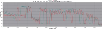

When the signal is good, any and every old LNB is working perfect here, for the very marginal evening levels the differences between LNB's become major, as every % quality counts. Best so far is still the Maximum single, see https://www.satellites.co.uk/forums...general-discussion.165653/page-20#post-934299.
Somehow LNB always been a little off towards L (manufacturing), finally got around to fixing it. Squeezed out a few Q %'s making it point to vertical center, prolonging R arm then readjusting dish. See picture.
