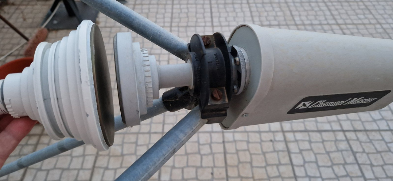

Do you guys have some info on this feedhorn, part number 3041107.
The holes on the feed does not fit any of my c120 LNB, do I have to drill it? It´s very big compared to the other CM feedhorn
Thats meant for connecting to a wave guide/filter "T" assembly, and used for both transmit and receive on large Ku band Andrews commercial grade dishes.
I don't think you will get it to directly fit any consumer grade LNB.

This was installed on a 96cm channel master, I have all the other parts that came with it (rejection filter, LNB, BUC etc) but if I drill the holes to match normal C120lnb does this Cm feedhorn will perform better than the CM feedhorn 3040661?

The R/T feedhorns will have a different bolt hole system to the usual receive only feeds.
It is possible to work the six way bolts into the eight way for the domestic systems.
Sell it and it should pay for the right front end.
