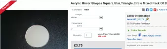

I will be taking it a step further Chris and checking my dish this way, its the best way to make sure your lnb is focused :).
Morning M.....interesting.
¿Can you please advise what diameter circular mirrors you are using.......online have seen various on Amazon, the Bay etc ?

Morning D, I am using these pal, I had some slightly larger ones but my grandkids claimed them:), but these are fine, really made a difference messing with the 1.2 dish allowed me to place the lnd on the spot :).
Acrylic Mirror Shapes Square,Star,Triangle,Circle Mixed Pack Of 20
Good work and thank you.......will order over the weekend along with other items.
