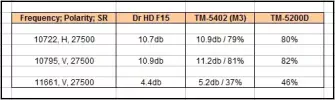

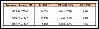

Just done a quick test with 3 different receivers for a few transponders, the results are in the picture attached below.
The TM-5402 (M3) is reporting stronger signal levels that the Dr HD F15.

CJ,
No picture breakup here using either F15 or TM-5402 (M3), however, I am a hundred or so miles further east, probably helping to prevent picture break up.

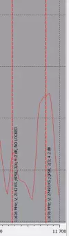

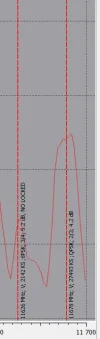

Just checked this now, not even the slightest hint of a signal! Rest of 7 West A coming in at usual levels. 1m dish West Yorkshire.
Archive4
Also getting 7W as normal, except 11661v. Getting approx 2.5db with intermittent lock. Adjusting my position from .4 w to .4 e and I get full lock at 7.7db.
Could be my set-up as I´m still playing with the motorised 60cm until I have it fine tuned
( was watching MBC action when I noticed the thread ) on which I go from 10.3 to 11.3db when I put the position correct to .4 w
