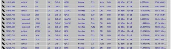

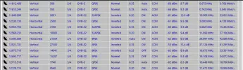

Of course what I'm picking up in my area,Romania,is not true for other location,including Surrey.But I think there are enough enthusiasts who want to find out about what they can be received on Yamal-402 in their area relative in my area with 150cm dish and lnb IBU.Here is a list of transponders which I found with EBS.Who knows,it may help...
