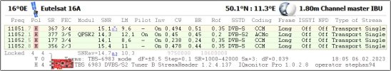

with TBS 6983 and IQMonitor
we find between 11051 and 11054 H four frequencies with very small SR and all are readable
