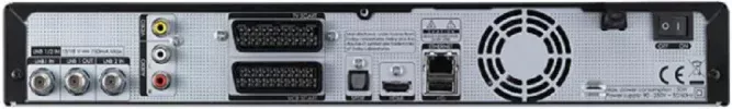

If your receiver is a clever one with an active loopthrough you can use it by 'daisy-chaining', one receiver powers on, whilst the other is off. Whichever one is providing the channel also controls the LNB and /or the dish motor
@ the OP
Very cheap (just a length of coax & 2x F-plugs) but obviously does require at least one of the receivers to have a 2nd "loop-through" F-connector socket.

Does any of the two receivers have a LNB loop through?
You can connect the LNB cable to the one having the loop through and the loop through output to the second receiver.
The HDMI outputs go to two HDMI inputs on your TV, assuming you have more than one.
But you must have only one receiver on.
Edit: I am not as fast as CH.
