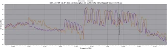

today morning new signal 12139v low power 1.5db

Well for me NO change in any signal levels this morning - so "the big move"didnt happen last night did it?
Seeing that here in Portugal...A little bit stronger but not the Pan Euro beam I think.
